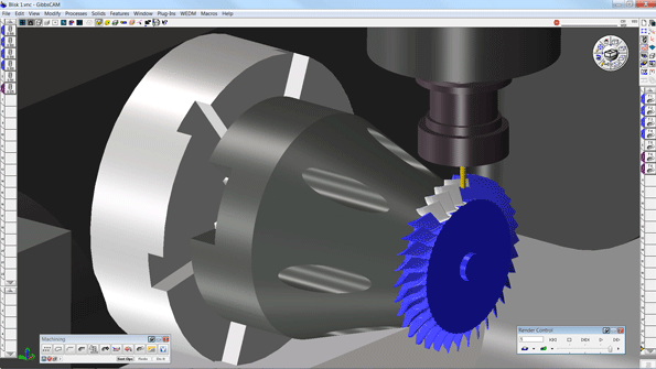

GibbsCAM 2012+ includes a Multi-Axis Rendering option that is provided free-of-charge now with each seat of the software; formerly, it was a $2,000 option.
Multi-Axis Rendering makes rotary milling applications significantly more accurate, especially when displaying toolpaths with continuous changes in tool position and orientation. Improved gouge and tool interference checking for tilting tools shows programming errors to customers before they become costly mistakes in production.
“We are pleased to be able to offer our customers such a valuable option free of charge,” stated Gibbs and Associates president and CEO Bill Gibbs. “A picture may be worth a thousand words, but being able to catch a tool collision before it gets to the shop floor can save customers thousands of dollars.”
Speed and productivity for all GibbsCAM users are improved because the GibbsCAM 2012+ rendering engine incorporate multi-core processing and multi-threaded computer hardware to accelerate processing. Part rendering speed is now up to 33 times faster, the developer noted, depending on specific computer hardware and part complexity. Increased rendering speed saves programming time and reduces programming costs.
