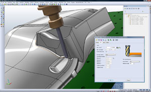

The mold for a carbon-composite seat shell started as a CAD model, then analyzed and converted to a design using VISI Modelling, and the toolpaths were programmed with VISI Machining.

Dean Challis is a design engineer with CAD/CAM and tool design experience, and through DeltaCAD Ltd. he provides design and manufacturing services ranging from 2D drawings to 3D modeling and CAM programming. For this project, the customer provided the original CAD model as a Unigraphics NX file, and the part analysis and tool design was performed using VISI Modelling from Vero Software.
Vero Software designs and develops CAD/CAM/CAE software for design and manufacturing, notably for plastic injection molding and progressive die forming.
"VISI is very tolerant of non-native data,” Challis explained. "When models are originally designed, the manufacturing requirements are not always known. To make a part manufacturable, it is vital to interact with the data and make the relevant changes. In regard to these particular components, and with authority from the original design team, the tooling was modified to remove undercut areas and apply blend radii on sharp edges.
“Typically,” he continued, “blending can be a very complex task and it is often necessary to ‘explode’ a model into surfaces and manually apply the CAD modifications. VISI is very strong at switching between solid and surface environments, and this allows us to make complex changes where other CAD systems often fall over."
The tooling was manufactured by Casting Support Systems Ltd., a company that supplies large tooling to investment casting, plastic molding, and gas turbine manufacturers. In conjunction with its sister company Versa-tote, it also designs and manufactures returnable transit boxes for warehouse and distribution centers across Europe.
All toolpaths were programmed with VISI Machining and the aluminum tooling was milled using XYZ 1060 high-speed vertical machining centers running Siemens 840D ShopMill Control, with WNT solid-carbide end mills that have been designed to cut softer materials like aluminum. The geometry of the tooling makes it possible to cut full slots to 1.5×D depth with high feed rates, typically twice that of traditional steel cutting tools. The tooling life for the cutters is approximately 3,000 hours.
The entire multi-surface tool was manufactured and assembled in just nine days, partly due to optimal toolpath usage and running multiple jobs at the same time.
Sam Cox, Casting Support Systems’ tool room foreman, explained: "Complex tools often contain a number of sub inserts where the setup time is disproportionate to the actual CAM runtime. To overcome this obstacle, we set up a number of individual jobs located around a single datum, which run overnight for lights-out machining. Although the machine can run at optimal production rates, we back off when running overnight to protect tool life. We use VISI to accurately predict the actual toolpath cutting time and program accordingly. A typical set of overnight programs will run for up to 14 hours."
