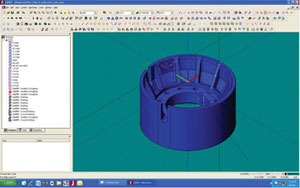

ESPRIT CAM displays a working model of the aluminum-bronze cylindrical gas turbine engine vane.
A detailed view of the cylindrical gas turbine engine, showing the numerous ribs that made machining so time-consuming.

"ESPRIT has helped us substantially improve programming capabilities, primarily by enabling us to reduce machining cycle time and programming time," Kempke said. He pointed to the example of a part that was centrifugally cast and then machined to the customer’s specifications on the company’s BTD 3-axis machine. The aluminum-bronze part is a cylindrical gas turbine engine vane that has a large number of ribs. Johnson started by importing the solid model of the part provided by the customer into ESPRIT.
The programmer selected a zigzag machining strategy, using a face mill for roughing out the part. He used a separate toolpath to cut out the area between each adjacent pair of ribs by creating a rectangle that defined the limits of each area to be machined. The zigzag strategy offers fast cycle time and excellent quality along vertical walls. This cycle optimizes the tool path by rounding internal sharp edges for high-speed cutting and providing G-Code output using G2/G3 circular interpolation whenever possible. The programmer used a single-direction strategy for finishing while taking advantage of ESPRIT’s rest machining capabilities that automatically develop an efficient method of removing the large amounts of material often required to cut castings to their final specifications. A 0.75-in., indexable insert ball nose end mill was used for semi-finishing, and finishing was performed with a 0.5-in. ball nose end mill.

The programmer then viewed a simulation of the machining operation with the goal of identifying potential opportunities for improvement. He was able to view the entire machining environment, including stock materials, fixtures and clamps, in dynamic, solid-shaded graphics. All the kinematic action of the machine was displayed in "real time," enabling accurate visualization of the entire machining process, machine movements, and material removal. He used the software’s built-in part inspection to compare the original "as-designed" part to the "as-machined" workpiece to assure part accuracy.
In this case, the programmer noticed that the tool was cutting air during a significant portion of the cutting cycle. The program was following his instructions by cutting out the boxes that he had used to define the area between each pair of ribs. The simulation revealed that the problem was that the area to be machined between the ribs was highly tapered, while the programmer had approximated its shape as rectangular. The air-cutting occurred when the program cut out a much larger than necessary area around the pointed side of the taper.
The programmer solved this problem by changing the toolpath definition to consist of a series of stacked rectangles that he progressively reduced to match the contours of the taper. This change alone reduced cycle time from the original 22 hours to 17 hours. The programmer also noticed in the simulation the potential for further improvements by increasing the Z-axis stepdown in the finishing operation. He tried several different values and each time viewed the simulation to determine the size of scallop on the surface of the part. He determined that he could increase the stepdown and still meet the surface finish specifications, further reducing machining cycle time to 14 hours.
The programmer generated additional timesavings by increasing feeds and speeds, increasing stepdown value on the semi-finishing operation and cutting only the corner rather than the entire wall in rest machining. These changes further reduced the machine cycle time to about 11 hours. The resulting 50% reduction in machining cycle time provided a proportional savings in the cost of machining the part.
