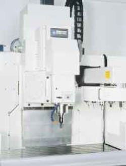

BostoMatic high-speed machining centers provide accelerations as high as 0.9g.

NURBS CNC suppliers claim faster machining times, but these are relative to older machines with antiquated controls or new machines and controls that don't provide the processing power and data storage needed for high-speed machining. To significantly reduce machining requires higher data-processing rates, along with support for higher accelerations and decelerations, superior machine geometry, real-time correction for thermal errors, and the use of new spindle and drive train technology.
Claiming that the exact same machine tool and control can cut a part significantly faster when NURBS is being used should generate questions about the design of the machine-tool system, since the potential of the machine tool is being hampered by the CNC's inability to crunch data. A system truly optimized for high-speed machining will be limited by the machine's dynamics. In other words, feedrates and more importantly, acceleration/deceleration will be limited not by the CNC's data processing rate, but by the frequency response of the electro-mechanical system, which includes the servo algorithms.
Many of the machines fitted with NURBS-based CNCs can only support accelerations of 0.2 to 0.3g. A true high-speed machining center should be capable of supporting accelerations from 0.5 - 0.9g when using ballscrew-based drive systems.
