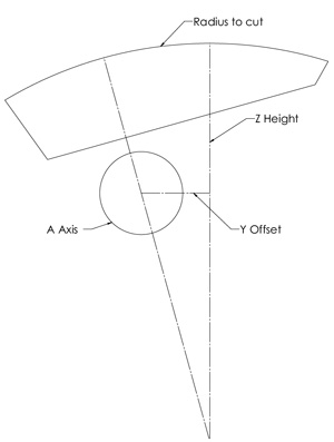

An example is cutting a large curved surface.
The radius of the main surface is 24 in. If you don’t have a lathe with a 24-in. swing, this becomes a difficult part to machine, never mind the large fixture it would take to hold the 8-in. by 14-in. by 3-in. piece of material. Setting this up on a fourth axis fixture makes machining the part practical.
Any point tangent to the surface can be calculated, and a Y, Z, A position for the machine can be determined.
First, calculate where the center of the arc of the part is in relation to the A axis.
Then, calculate where the tangent point is.

First, you need a series of numbers to represent the angles of the A axis.
To determine the angle of rotation required to complete the arc, use trigonometry:
SIN(a)=5/24, a=12.02, SIN(b)=9/24, b=22.02
Round the answer to 12.1 and 22.1, respectively.
For troubleshooting purposes, it is best to break your calculations into individual steps.
This is where Excel is a great tool. Each column can become one step of the calculation, and that gives you an easy way to see errors.
Remember: Excel works in radian, not degrees. Therefore, you will have to use the RADIANS formula command to convert to radians and the DEGREE command to convert back to degrees.
The Y position is calculated as follows:
Sine of the angle X 18 (distance for center of A axis to arc center) Y=SIN(RADIANS (A$2:A$344))*18
The Z position is calculated by:
24(radius) minus the cosine of the angle times 18
Z=24-COS(RADIANS (A$2:A$344))*18.
