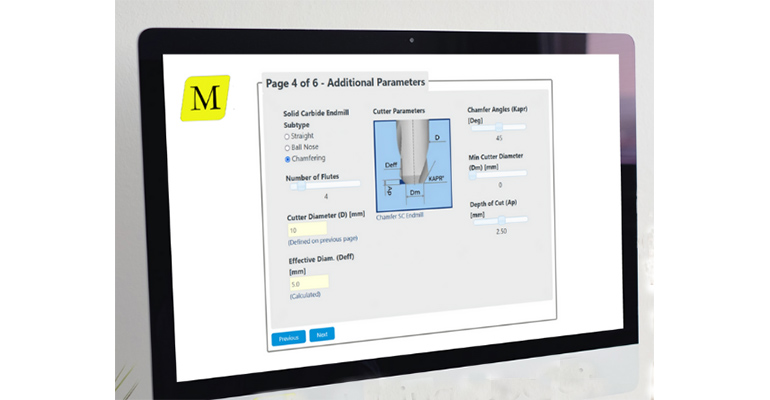

The main calculator on the website is the Speed and Feed calculator. It provides cutting data and carbide grade recommendations for Milling, Turning, Parting, Grooving, and Drilling operations based on dozens of parameters like Raw material, Hardness, Tool Geometry, Stability, Grade selection method, and many more.
The results include Cutting Speed, Feed, and additional data such as cycle time, power consumption, surface finish, etc.
The calculator is constantly being upgraded with new features to add functionality and improve the accuracy and user interface.
