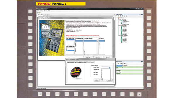

Its new FASOPC was designed to draw machine production data out of a Fanuc CNC and off the shop floor, it said, more easily than before.
The FASOPC server communicates with Fanuc CNCs programmed with FOCAS (a series of dll library files that can access almost all of the information inside the CNC), to read and write data with efficiency. The configuration utility’s intuitive user interface uses ‘wizards’ specifically designed for the Fanuc CNC to guide users through the processes of setting up all of the controls.
Once a control type is identified, then data only relevant to that control type is presented to the user. There is no need for additional knowledge of Fanuc CNC capabilities to use FASOPC.
FASOPC supports OPC DA specification 3.0, 2.0, and 1.0 gives it flexibility to serve data to most OPC clients now commercially available.
