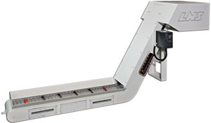

The Turbo MH250 chip conveyor operates with only one motor and belt, filtering all chip types, shapes, and materials — faster, and using less energy.

Unlike most of the other conveyors, the Turbo MH250 operates with only one motor and belt, filtering all chip types and shapes as well as all kind of materials. The energy consumption has been cut down by 50%, making it one of the most environment friendly filtering conveyors on the market.
“The self-cleaning conveyor does not only save energy, it also saves time,” according to Towers. “In a specific case one of our clients had to carry out maintenance on his existing conveyors – including extracting and cleaning conveyors and tank – every six weeks. Now he only has to do it once every year.”
According to LNS, the machine’s versatility, ease of maintenance, energy efficiency, and the reduction of downtime that it makes possible, the Turbo MH250 is very cost-effective. “We did not re-invent the wheel. In the innovation process, it’s all about being smart: We optimized the strength, improved the design and reliability while not significantly increasing costs,” explains Towers. It is easy to upgrade the existing Turbo MH500 to a new Turbo MH250.
