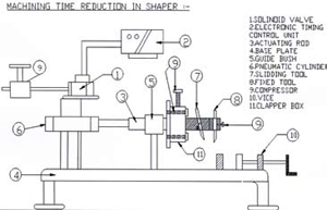

Shape up for high production
My idea is to use a shaper for high production by turning the machine’s idle stroke during its return motion into a cutting stroke. Doing so reduces workpiece machining by half.
I accomplish return-stroke machining by adding a clapper box with a tool, such that the toolholder arrangement has one tool clamped on the clapper box individually. The return stroke now becomes a rough-cutting one as compared with the forward one. Pneumatic power, with control accessories, drives the machine’s ram or cylinder piston for forward and return strokes.
L.M. Lakshmanan,
Coimbatore, South India
