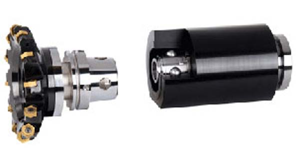

By combining high clamping force and optimized interference levels, KM4X provides a robust connection, extremely high stiffness, and bending load capacity for greatly improved performance in machining high-strength alloys and other materials, enabling extremely high metal removal rates and more completed parts per day.
The KM4XTM spindle-connection system from Kennametal has a heavy-duty configuration capable of performing in high-speed, low-torque or low-speed, high-torque conditions. Without KM4X, helical cutters such as this would exceed bending moment constraints long before reaching torque limits.
Surface contact and clamping force combined for improved interference fit and three times the bending moment resistance compared to other systems. Tool change is quick and easy, minimizing machine downtime.

KMTM quick-change tooling consists of two basic components: the clamping unit and the cutting head. The clamping unit mounts to the machine tool (a turret or tool block for stationary applications and a rotating spindle to accommodate rotating applications) and is the receptacle for the interchangeable cutting unit/toolholder. When a tool change is necessary, an operator simply releases the locking system, replaces the cutting unit, and locks it into position. Machine downtime is a matter of seconds.
KM4XTM from Kennametal represents the next generation of KM. Some systems may be able to transmit a considerable amount of torque, but cutting forces also generate bending moments that will exceed the interface’s limits prior to reaching torque limits. By combining high clamping force and optimized interference levels, KM4X provides a robust connection, extremely high stiffness, and bending load capacity for greatly improved performance in machining high-strength alloys and other materials, enabling extremely high metal removal rates and more completed parts per day.
