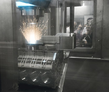

The process Heller is standardizing melts iron/carbon wires and uses gas to spray the molten metal onto the surfaces of engine cylinders — to improve combustion efficiency in automotive engine blocks.

Nanoslide is a twin-wire arc spraying process that melts iron/carbon wires and sprays them onto the cylinder surfaces of an aluminum crankcase, with the help of a gas flow. Compared to other thermal coating processes, the technology is considered highly cost-effective and technologically superior. However, finished product quality requires optimal calibration of current, voltage, wire feed, process gas flow, and other quality-determining parameters.
