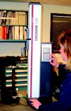

NSK Steering Systems America Inc. (www.nssa.nsk.com), one of the world's largest independent makers of steering columns and associated components for customers such as Ford Motor Co., Toyota Motor Corp. USA, Honda of America Mfg. Inc., Mazda USA and Mercedes-Benz US International, initially purchased Digimar CX2 height gages to measure tall parts in the vertical position. However, the shop got more than it bargained for in that the gages not only accommodate the tall parts, they also provide speed and efficiency for keeping up with rapidly growing production demands.

"We have three CMMs for final inspection, and they were running 24 hours a day. So we had an issue with piece part inspections," says Tom Leab, metrology and inspection group leader at NSK. "We had to wait to get on the CMMs, and since the largest was only 24 in., we ended up using precision V-blocks and things of that nature to raise it up. We just didn't have the height," he says.
Two Digimars that handle parts up to 40-in. long rest on a 60 120-in., 20-in.-thick, granite surface plate in NSK's inspection lab, and two people can use the gages simultaneously, which saves a lot of time. The company also has a Digimar height gage in its metrology lab, where it supplements an older height gage that is difficult to use.
The computer touch pads on the Digimar gage walk users through measurements, making it easier to use than the older height gage, Leab says.
