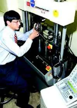

Jonathan Lee prepares to test the strength of the new alloy MFSC-398, which he co-invented with PoShou Chen, a scientist with Morgan Research Corp. The new high-strength aluminum-silicon alloy promises to lower engine emissions and improve gas mileage in cars, boats, and recreational vehicles.
