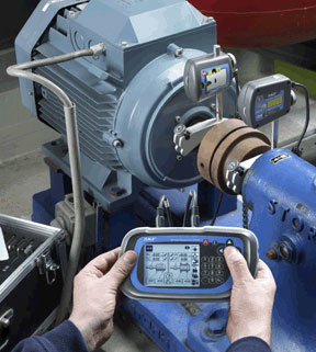

Maintaining alignment requires regular monitoring, and SKF’s TKSA laser-guided shaft alignment systems are designed for novices as well as experienced users, with built-in procedures that cover process preparation through to correction, and results documentation.

Today’s laser-guided tools are quick, easy-to-use and accurate. They typically consist of two units that emit and detect a laser beam, and a handheld control device. The handheld device displays real-time coupling and foot values (which indicate moveable machine foot positions to facilitate corrections) during the alignment process, eliminating the need to remove and reinstall the measuring units after each adjustment. In addition, the laser system tool documents the values, which can be downloaded to a computer and used to benchmark future alignment inspections.
