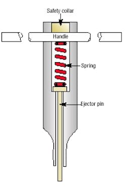

My special chuck-wrench design, incorporating a spring-loaded ejector pin, prevents accidents caused by leaving the wrench in lathe chucks. To accommodate the ejector pin and spring, I drill through and counter bore the center of the wrench. The wrench ha
May 1, 2005

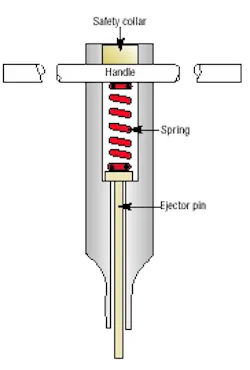

My special chuck-wrench design, incorporating a spring-loaded ejector pin, prevents accidents caused by leaving the wrench in lathe chucks. To accommodate the ejector pin and spring, I drill through and counter bore the center of the wrench. The wrench handle keeps the spring in place, but I install a safety collar secured by a setscrew to keep both spring and ejector pin in place if the handle is removed.
Noshir Kapadia
Thane, India
