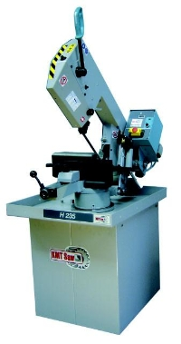

The H235 is designed for light-duty cutting of tubes, pipes, light structural shapes and small solids up to 8 in. at 90 degrees. The saw has a variable speed blade from 65 to 320 fpm and can accurately miter up to 60 degrees to the right. The saw uses a single-phase power supply and transforms it to 230 volt, 3-phase to power a drive motor coupled directly to a worm gear drive. The company says the heavy-duty construction,
including carbide saw guides and rigid guide supports, ensures accurate, straight cuts. The saw has manual sawframe raise/lower, manual vise, hydraulic/solenoid powered down-feed and status indicators for power on, correct blade tension, broken blade and bandwheel cover open.
