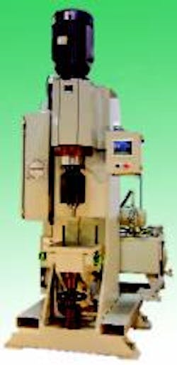

The Model P-1500 hydraulic orbital forming machine handles mild steel measuring more than 1.5 in. in diameter and equivalent areas in tubing, square, and other forming materials. Its maximum downward force is 38,500 lb (19 tons) at 1,000 psi hydraulic. To
June 1, 2004
The Model P-1500 hydraulic orbital forming machine handles mild steel measuring more than 1.5 in. in diameter and equivalent areas in tubing, square, and other forming materials. Its maximum downward force is 38,500 lb (19 tons) at 1,000 psi hydraulic. Tool stroke adjusts from 0.06 to 3 in. in 0.001-in. increments. Standard throat depth is 9.75 in., and vertical-saddle-height adjustment is 12 in.
