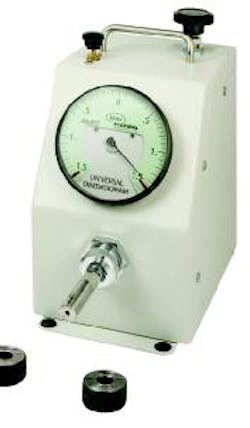

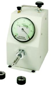

Mahr Federal Inc., (www.mahr.com) has enhanced its Dimensionair product line with the new Universal Dimensionair, an adjustable magnification air comparator that combines the stability, accuracy and fast response of a differential air system ...
Aug. 17, 2006
Mahr Federal Inc., (www.mahr.com) has enhanced its Dimensionair product line with the new Universal Dimensionair, an adjustable magnification air comparator that combines the stability, accuracy and fast response of a differential air system with the ability to work both as a single master or dual-master air gaging system with built-in magnification and zeroing controls. By selecting the appropriate dial configuration, the company says the Universal Dimensionair can be adjusted for use with virtually any dual-master air tooling or span master.
