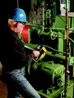

In-house thermography surveys save money and prevent unexpected production shutdowns.
Fluke's Ti20 thermal imager makes in-house thermography surveys affordable.

Portable thermal imagers, such as the Ti20, ease the implementation of in-house thermographic surveys, Blaisdell says. "The instrument targets industrial-maintenance technicians that are not doing thermography on a daily basis and need a camera they can pick up and quickly use after not having done so for a while," says Blaisdell. Ease-of-use is especially important if several shop personnel are sharing one camera, he adds.
While some imagers require that users go through multiple, embedded menu structures, the Ti20 is designed as a simple focus-and-shoot, triggeroperated instrument. Users can manipulate or post-process images on the camera or on a personal computer using software that is included in the equipment package.
