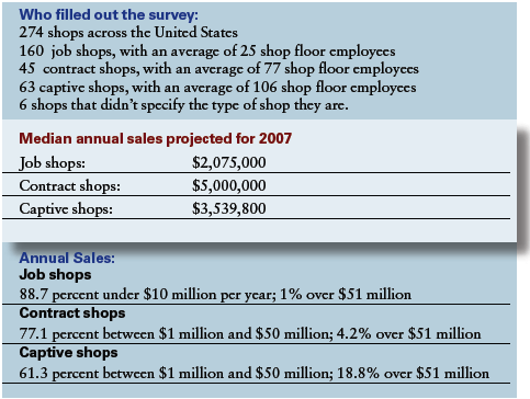

By Bruce Vernyi and Lawrence Haftl
American Machinist has conducted its second annual survey of machine shops to gather information our readers need to accurately gage their competitive positions in the industry, and to help them make plans that will enable them to systematically improve their operations and become more competitive.
We have identified key indicators and best practices that lead to improved productivity and profitability and, with the responses to questions about those indicators and best practices, we are able to identify a set of shops whose performance puts them in the lead of all the shops surveyed.
That group of shops is our benchmark set, and represents the top 20 percent of shops that responded to the survey. The results for the Benchmark shops are composites, so they do not represent one shop's performance, but the combined performance from all the best shops. We believe these performance results and the practices that lead to them provide targets that all shops can strive to reach, and they provide performance measurements to which all shops can compare themselves to check their current competitive positions and their progress in reaching higher degrees of efficiency.
To analyze the survey data, we summarized the data for all shops, and compared that data to the information on the Benchmark shops percent.
For example, on an overall basis, 74 percent of the shops that responded to our survey said they are independent and 26 percent are part of a larger company. For the benchmark shops, 83.3 percent are independent, and 16.7 percent are part of a larger company.
We also tabulated the data by the type of shop; whether they are job shops, contract shops or captive shops; and we tabulated the data by employment levels, to compare companies with 1 to 20 employees, companies with 21 to 50 employees and companies with more than 50 employees.
We grouped the survey questions into the following categories: Profile information, human resources, strategy and operations, inventories, capital equipment, supply chain and information technology, and we will be providing analyses of data based on those different groupings in the coming months. For anyone who is eager to see the raw data, we will post that entire set of numbers on our internet site, (www.americanmachinist.com). The data will be posted under the "community" hot button near the top of the web page in a drop-down menu by July 15.
