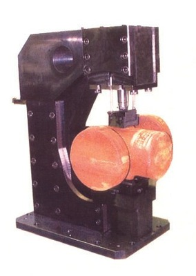

Royal Machine and Tool built its Special "C" Frame Fixtures to reduce the number of operations required by clamping large valves on the parts' bodies, rather than on the flanges. Changing the clamping position allows valve body flanges and weld connections to be machined completely in one setup. The fixture uses interchangeable top clamps and nests to increase their versatility so they can accommodate a family of parts.
