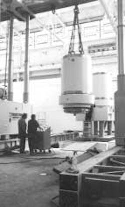

The EZ Lifter positions one of two hydraulic cylinders weighing 50-tons. The cylinder holds parts in place during for hydroforming.

The first lift involved placing the press' 140-ton base in a 20-ft-deep pit, which was pitched to collect and recirculate discharge water. The second lift placed a 30,000-lb., 8-in. bolster plate for holding dies. With lifts three and four, the company positioned two hydraulic cylinders weighing 50-ton each and four support columns.
Once the cylinders and columns were installed, Industrial Erecting used a 70-ton crane to put in the tie rods. The final lift with the EZ Lifter positioned the press' 129-ton crown.
