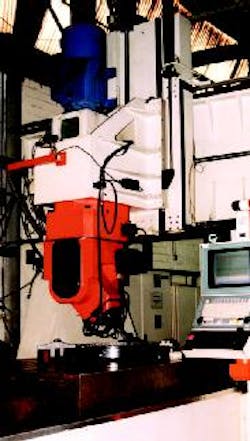

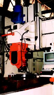

Continuous five-axis machining powered by Delcam CAD/CAM technology improves mold-surface finish quality and eliminates polishing operations at Quantum.
Quantum Engenharia e Montagens Industriais, a tire-mold manufacturer in southern Brazil, cuts its 3D-modelling time from three weeks to one and slashes machining times by almost half. While few Brazilian companies in the industry use CAD/CAM technology, it is the key to Quantum's fast modelling and machining.
The shop partners Delcam's PowerShape CAD software with a PowerMill CAM system. Once the shop receives a 2D drawing, it creates a 3D digital model in PowerShape and discusses any possible alterations or improvements with the customer's designer.
Upon approval, the shop converts the model into machining data for producing a mold. Until recently, Quantum used PowerMill only for positional five-axis machining, but now the shop does continuous five-axis work.
Positional five-axis machining left unpreventable marks on tire molds. But with continuous five-axis machining, along with the Delcam CAD/CAM technology, the shop not only improved mold-surface finish quality, it eliminated polishing operations.
