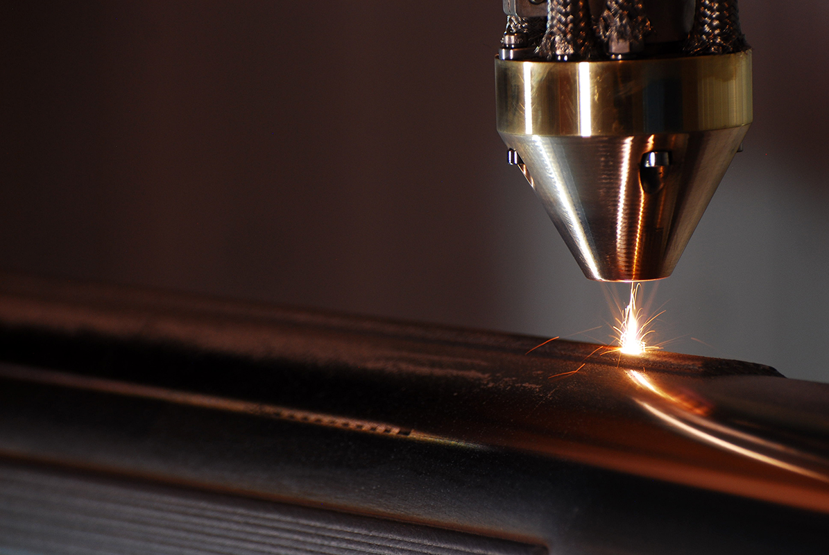

What is laser cladding? — Laser cladding, also called "laser deposition," involves the use of filler material to create a metallurgical bond between a metal substrate and a metal coating. The filler material generally arrives in powder, strip, or wire form and gets introduced to the heat of the laser coaxially or laterally. By using multiple powder types and adjusting the feed rate of each, it's possible to create components deposited with multiple materials or even components with material gradients.
Laser cladding comes into play in a wide variety of industrial tasks — including applying surface coatings, rapid manufacturing and repairing worn-out parts. CO2, Nd:YAG (neodymium-doped yttrium aluminum garnet), and fiber lasers are the three types of lasers in this process, which is useful for several reasons:

Compared with traditional cladding and welding techniques, laser cladding provides a high-speed thermal cycle that makes it possible to achieve higher hardness as well as much finer microstructures — two characteristics that help to resist corrosion.
Laser cladding also offers the benefit of a limited heat-affected zone, which has numerous advantages: It reduces the amount of trauma to the part or workpiece, cuts down on the likelihood of deformations, and allows the process to take place alongside other critical areas that are less tolerant of heat, including adjacent edges and walls. That means laser cladding can add structural reinforcement to sensitive areas.

What is laser welding? — Laser welding is a process in which a laser melts two different materials together. It's useful for joining tiny electronic components, as well as larger steel structures. The most common types of lasers used here are CO2 — delivered by mirrors — and Nd:YAG — delivered by fiber optics.
However, thanks to their higher power output, CO2 lasers can join much thicker steel plates — up to 1.5 inches thick — which Nd:YAG lasers cannot do.
Laser welding differs fundamentally from laser cladding in that it does not require a filler material. For applications that require joining dissimilar materials, manufacturers can include an interlayer with IR-absorbing qualities.
Like laser cladding, laser welding also produces a minimal heat-affected zone and little thermal distortion. Other advantages include high-productivity and high-speed operation.
