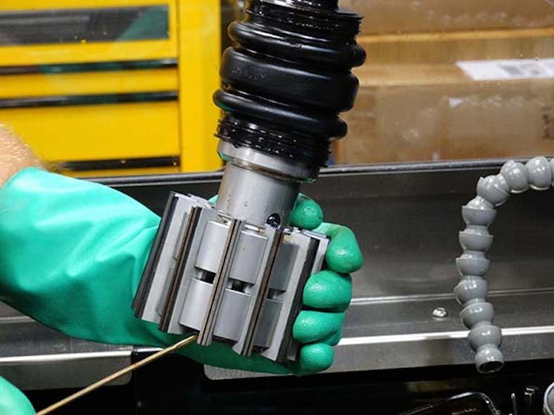

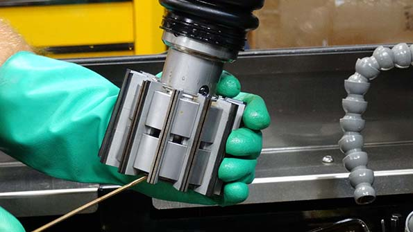

Diamond stones in Sunnen’s 12-stone honing head have been a great aid in achieving good bore geometry on the total cylinder length, Ferri says.

Diamond stones in the 12-stone honing head have been a great aid in achieving good bore geometry on the total cylinder length, he added. "In the past, we would make tapered 'cheater' stones to take out more metal at the bottom of the bore to get the taper out," he explained. "The multi-stone diamond tool produces excellent roundness without special work. This much abrasive contact in the bore also requires a powerful spindle to turn the tool without chatter, which can ruin a finish. This machine handles it easily. Spindle reversal was another new capability on this machine, and we do use reversal — but we are still working to determine how and when to use it for the best effect."
