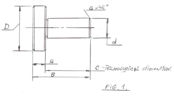

1. Before starting to design a new instrument for any technical function involving some level of detail, a tool designer must first acquaint himself with a drawing of this detail -- and all the technological operations of this detail, as well as the cutting tools and measuring instruments for these operations. This study will save the designer from many possible mistakes in the course of the project.
2. Dimensions A design and B — design dimensions are used for as function (See Figure 1.)
For example: a designer is given dimensions A and B to proceed from work detail in the unit. But, for the technological operation of a turning tool, the designer must give side C = B-A, with C as a technological dimension.
