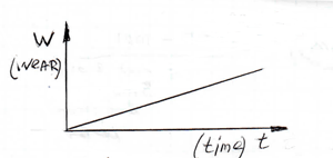

Figure 1: The wear effects of time during machining.
Wear depends on a lot of factors, especially time, as illustrated in Figure. 1. Variable forces during the cutting process also influence wear – and the more forces are at work inducing more wear to the tool. In this article, we show difference sketches of wear.
