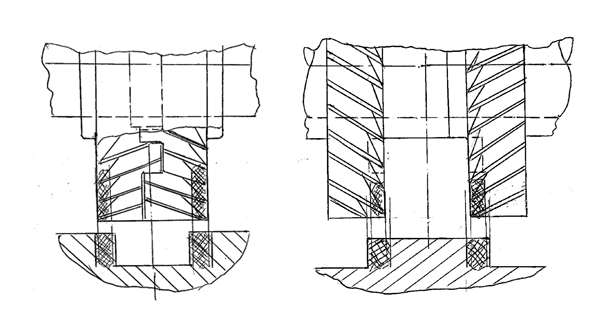

A sketch not drawn to scale showing the principles of the relationship between cutting tools and the allowances for details on the left is the machining slot on the right is the machining cutter

When a tool designer develops cutting tools, he must understand some basic principles about the allowances for detail and the cutting tool design.
1. There is a ‘golden rule’ for cutting tools: the allowance for a cutting tools is always located inside the allowance for a hole or groove, and it s less than the allowance of holes, slots, or cutters.
2.  Next, it is a very good practice to make a sketch of the locations of these two allowances, to see a correct image of the design, and to avoid mistakes.
3.  Then, in order to use the full material of the cutting tool we must fix a maximum allowance for the cutting tool, which is less than the maximum allowance for the hole or groove.
4.  Next, when the diameter of the cutting tool reaches a minimum of the cutting tool allowance we must take it out of the machining operation. All machining must be done under control.
If your task is to machine a hole diameter that is
20+0.140 maximum and
20+0.000 mm minimum by counterbore,
the diameter of that counterbore will be 20.100+ 0.003 mm for the maximum diameter of the ready counterbore.
If, during machining, the counterbore gets to a diameter of 20.040 + 0.005 mm (minimum diameter), then we need to take it out of the machining operation.

When you machine long, precision slots or blocks with large numbers of details, it is more economical to us sets of plain disc cutting tools than to use one cylindrical milling cutter, because it does not have to be reserved for grinding.
For the design of a set for milling slots with two disc cutting mills, the tool designer must remember the Golden Rule about the relationship between the allowances of the slot and cutting tools.
If you are machining a slot
30+0.140 mm maximum
30.000 mm minimum
then, a set of two plain cutting mills will have
M.T = 30.120 +/-0002 mm maximum size
to start machining, using full material, and the size of the edges will have
 30.040 +/-0.002 mm minimum size.
After this, proceed to the regrinding of the wear set.
For regrinding: between the cutting tools there is sometimes located a ring with good surface that contacts the cutting tools. After regrinding the wear from all cutting edges and making new edges we make a measuring set from edge to edge, and the result is
G.T. = 29.000 + 0.002 mm (for example),
meaning that the additional ring will be
G.R.  = 30.120-29.000 = 1.120 +/-0.002 mm.
