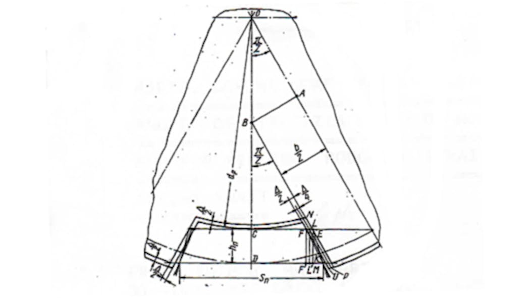

Sketch 1 is a general depiction of the disposition of the tooth of the hob and the splined shaft.
When we study the hobbing process and design hobs for roughing straight-sided spline shafts we use the following formula to define the angle of trapezia teeth of the hob:
Sketch 2.

If you look at sketch 1 you will see a general picture of the disposition of the tooth of the hob and splined shaft.
Sketch 2 shows the process of hobbing the spline by teeth a1, a2, a3, and curves 1, 2, and 3 suitably covered the spline.
Sketch 3 shows process of hobbing the spline by teeth with angle a1 = 13 degree, with tolerance for grinding 0.167 mm, which is less than the normal tolerance.
0.225 mm on the one side of the spline, which is made by teeth angle a2 = 16 degr. 10 min. on sketch 4.
Sketch 5 shows the process of hobbing by teeth angle a3 = 19 degrees, with tolerance for grinding ^= 0.267 mm on one side of spline, which is good for a long splined shaft.
Now, the tool-designer can make his decision after completing a graphic check of every variant.
