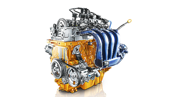

As part of Fiat Chrysler, Fiat Powertrain operates several manufacturing plants around the world, including four in South America. The Campo Largo plant, near Curitiba, Brazil, manufactures 1.6-liter and 1.8-liter E.torQ flex-fuel engines for medium-sized cars that can run on petrol or ethanol.
The E.torQ series was developed by Fiat Powertrain and started in production at Campo Largo in 2011. The engine block has cylinder head fittings separate from the cylinder jackets. The threads are positioned in the upper part of the water jackets, with the connections between the jackets and the outer dimension of the cylinder kept apart from the cylinder head fittings.
