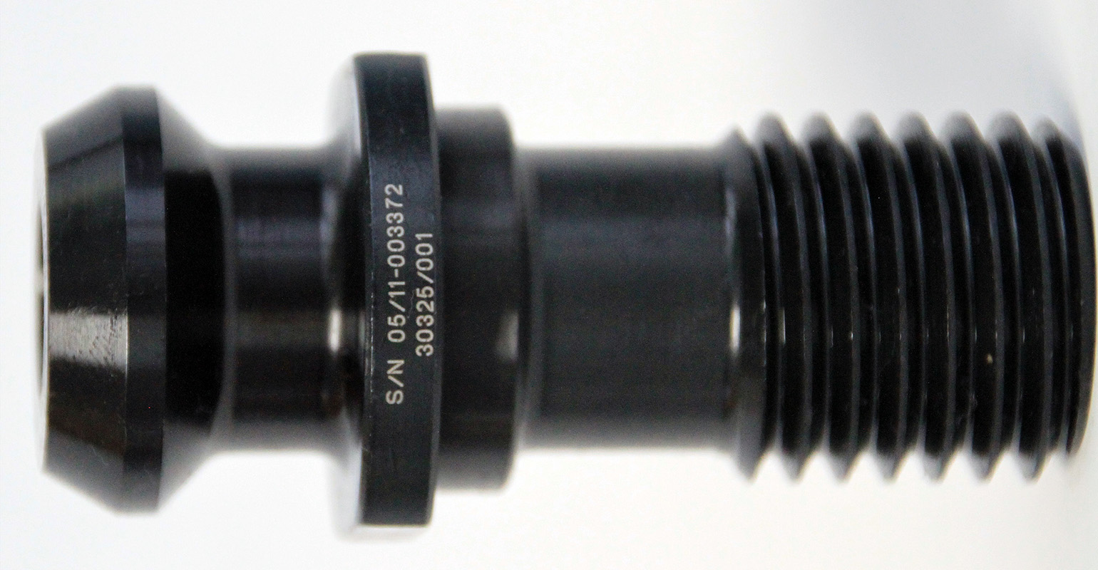

The flaw in the system — Although the shank of tapered toolholders is ground to a fine finish to fit in the spindle within very precise, established tolerances, those that use drawbars are also threaded at the narrow end to accept a retention knob. The knob is designed to engage with the drawbar, which exerts a pull force that holds the toolholder firmly in the spindle.
The problem is that poorly designed retention knobs – parts costing less than $20– when tightened create a bulge in the taper that prevents full contact and proper seating in the spindle. Once this expansion occurs, the toolholder will not pull fully into the spindle, and so it cannot make contact with up to 70% of its surface.
Perhaps because the shank and spindle are so carefully machined, or because machinists have used retention knobs on tapered products for decades, this issue has largely been overlooked. However, the results are evident in a wide range of CNC milling issues often attributed to other causes: vibration and chatter, poor tolerances, non-repeatability, poor finishes, shortened tool life, excessive spindle wear and tear, run-out, and shallow depths of cuts.
High-torque retention knobs — There are solutions on the market today that address this design flaw. In 2009, JM Performance Products Inc. introduced its High Torque retention knob. Invented by John Stoneback, it works with all existing toolholders, including BT, DIN, ISO, and CAT toolholders from 30 taper to 60 taper.
The High Torque retention knob is designed to be longer than other options, to reach deeper into the threaded bore of the toolholder. As a result, all thread engagement occurs in a region of the toolholder where there is a thicker cross-section of material to resist deformation.
It also includes a precision pilot to increase rigidity, and is balanced by design. Because over-tightening of even the High Torque retention knobs can create a bulge, JMPP provides specifically calculated torque specs based on drawbar pressure.
By combining the High Torque retention knob with the correct torque, spindle contact with the taper is improved to close to 100% every time. This can be verified by a simple, six-step “touch off” test (www.jmperformanceproducts.com/toolholder-test.aspx). More sophisticated measurement of toolholder expansion (bulge) also can be taken using a taper shank test fixture.
