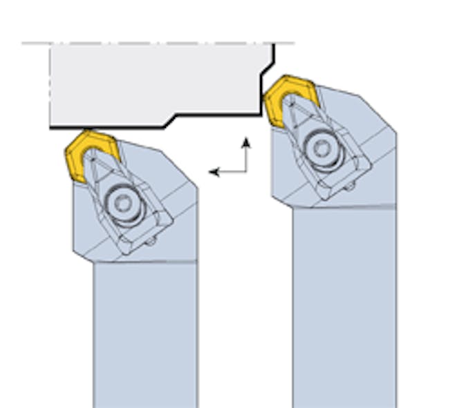

Net Surfing to Longer Edge Life — At Busche-CNC in Albion, Ind., a simple retooling de-bottlenecked the rough turning operation for difficult-to-machine wrought 5130 and hardened 4140. Previously, cutting edges cratered after an average 20 pc on the 5130; toolbars snapped every other day. The Ingersoll Hex-Turn inserts improved edge life nearly 10 to 1, and eliminated completely the unpredictable, cutting-edge rupture and all the hazards and disruptions that followed.
Now, a single tool completes both roughing and finishing. Moreover, the machining operation has been able to raise its feed rates and throughput by 50% on the wrought stock, and 50% on the hardened material — with no trade-off in edge life.
Busche-CNC in Albion, Ind., operates seven machining cells, like this on, to produce 2.75 million automotive ring gears per year, in 5130 forgings and hardened 4140 bar stock. Ingersoll Hex-Turn inserts, with a stronger cross section, improved edge life by 8 to 1 and completely eliminated sudden insert failures.

The primary reason for the big improvement in cutting-edge security is the Hex-Turn insert’s stronger geometry, according to Ingersoll turning product manager Ed Woksa. “On the one hand, the insert has a 45-degree lead angle that thins the chip and reduces notch wear,” he explained. “On the other, the hex shape is closer to a true round, intrinsically the strongest shape due to the absence of stress-raisers.”

Figure 2 — This sketch shows how a single Ingersoll Hex-Turn tool handles both OD turning and facing at Busche CNC.

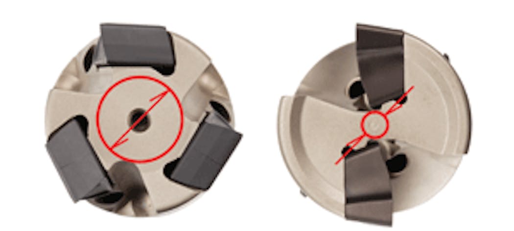

Figure 3 — This diagram shows how the insert’s strongest cross-section aligns with main cutting force vector and converts shear forces into compressive forces. (Left: tangential milling cutter. Right: conventional cutter). Inserts lie flat, rather than upright, in the pitch circle. Combined with a positive rake and helical geometry at the cutting edge, the tangential cutter is fundamentally stronger and more secure in heavy roughing operations, even on older, worn, loose machines prone to vibration and pounding.

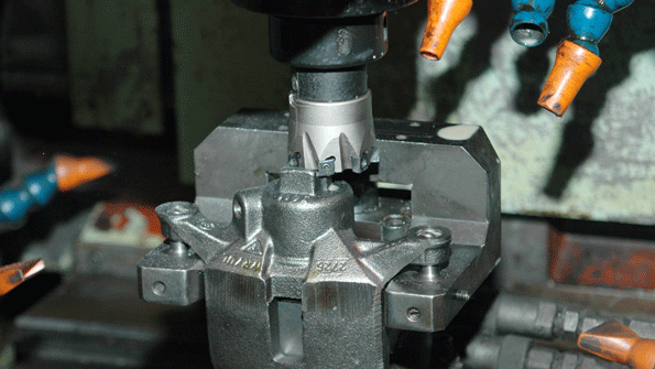

Akebono produces the brake calipers in an auxiliary machining cell that feeds a traditional transfer line (see Fig. 3). Because the whole operation is synchronous, there’s no way to speed up a single operation without unbalancing the whole line.
One troublesome operation in the cell is rough milling a 1.1-in. hose mounting area on the caliper. It’s an interrupted cut that cratered cutting edges and often set off the machine’s vibration alarm. “We were getting 7,100 parts per edge with a conventional 4-pitch cutter, and we were satisfied,” said Terry Alvey, Akebono central purchasing manager of indirect materials. During a plant visit, however, Ingersoll field engineer Paul Nugent spotted the operation and the opportunity to do better. He explained the TM concept and suggested a trial run for the new 2 inch S-MAX tangential cutter.
To make a short story long, the tangential inserts ran through 127,000 parts – four months – before requiring a change due to edge wear and deterioration of surface finish. That amounted to an 18-to-1 gain in edge life.
There’s more: It wasn’t until two days into the test that an operator realized that the vibration alarm hadn’t gone off even once. The new, smaller TM tools smoothed out the cutting action just as the larger ones have for decades.
When inserts are oriented tangentially, more inserts can fit on a cutter size for size, thereby distributing cutting forces more widely for smoother cut. Also, insert pockets don’t cut as deeply into the cutter body, which leaves more metal intact for a sturdier cutting platform. New Ingersoll 2 inch S-MAX Micro tangential milling (TM) cutter (l) fits seven effective inserts in the same circle as a conventional cutter (r), which can fit only four. Note how little of the TM cutter body needs to be machined away to provide insert pockets on new cutter.
Also aiding smoother cutting was the higher insert count in the cutter, made possible by the tangential design. The new 2-inch tangential S-MAX has seven inserts, versus four in the previous 2-inch cutter. “Under the same parameters, more inserts means lower cutting forces on each one,” Forman explained.
