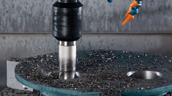

A closeup view of the holemaking process shows the Ingersoll HiFeed Deka face mill producing chips partway through a complete hole The tool withstands the lateral and impact forces associated with corkscrew milling the developer noted and because it has twice the diameter of the previous solidcarbide end mill it is less susceptible to deflection and it leaves no slug

For ideas he asked Ingersoll’s Chris Pope, who suggested the corkscrew technique using a larger-diameter indexable mill with high feed inserts.  “In corkscrew milling, the cutter advances continuously as it orbits,” Pope explained.  “And, the high-feed insert geometry means you can advance faster with shallower cuts, getting through the material faster while reducing cutting forces and spindle loads.”

In Chris Pope’s first trial run at Baldor, a three-flute Hi-Feed Dekamill running in the corkscrew mode completed each hole in five minutes, as opposed to a 17-minute cycle recorded for a comparable job with the orbiting method.  For the trial, the cutter advanced helically 0.031-inch per “orbit,” opening the hole in six revolutions, and it orbited at 214 IPM versus 12 IPM for orbital milling.  Surface speed was 800 SFPM, versus 335 SFPM.

The production gains achieved at Baldor Gainesville stem from a total method change based on completely different tool designs, according to Ingersoll’s milling product manager Mike Dieken.  “First, the cut is continuous down the helical toolpath, not start-and-stop,” he began.
“Second, the indexable tool has twice the diameter as the solid-carbide mill and it has a steel cutter body,” he continued. “This makes it much better able to withstand the lateral forces involved inherent in the process at those high MRRs.  Moreover, the 70-degree lead angle helps mitigate the impact and lateral forces at entry.”
He added that the combination of high-feed insert geometry and fewer flutes achieves much higher chip loads.  “The 1.5-inch indexable Hi-Feed Deka face mill can withstand feed rates of 0.015- 0.040 inches per tooth, versus 0.002-0.006 for a 3/4-inch solid carbide mill, Dieken continues.  “And, with fewer flutes, there is more room for the chips that come off so much faster.”
The change also removed a wild card, added Chris Pope.  “Because most holes at Gainesville measure less than three inches and the 1.5-inch tool covers more than half the diameter, there is no slug to upset things.  All the metal exits as chips.”  (Since he led the process change at the Gainesville plant, Pope has joined Gamco Services, Inc. Baldor’s principal integrated supplier.)
