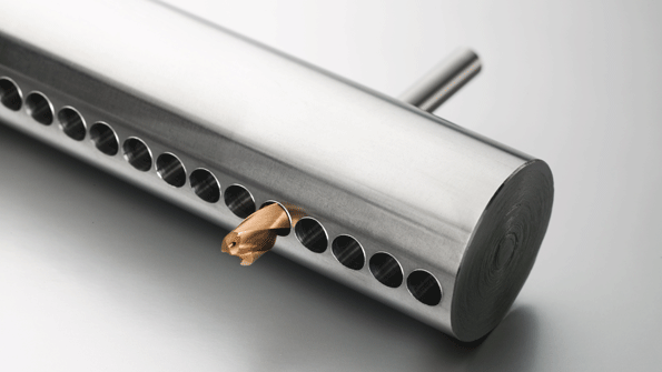

Cutting tool specialist Sandvik Coromant has studied the drilling process over the course of many decades, and each successive generation of drills has offered improvements over previous product families. Now however, the bar has been raised with Sandvik Coromant’s CoroDrill® 860, which it claimed represents the fastest solid-carbide drill now commercially available.
This high-performance drill can be applied to a range of holemaking tasks for maximum cost-per-hole reductions in steel workpieces, including long- and short-chipping steel materials, including: unalloyed steels, low-carbon steels, low-alloy steels, high-alloy steels and steel castings. For instance, aside from conventional drilling and stack drilling, CoroDrill 860 is highly proficient at producing chamfered holes and cross-holes, as well as holes through inclined or convex/concave surfaces. Excellent chip evacuation control makes it possible for the drill to provide consistently economical, problem-free drilling at high penetration rates, to boost hole quality and tool life.

The secret behind CoroDrill 860 and its ability to provide competitive and economical drilling is a completely new geometry combined with an novel flute shape that offers a cutting edge optimized for effective chip clearance, even at increased rates of penetration. An ER treatment helps protect the cutting edges further and makes possible controlled and evenly distributed wear formation.
The drill point is designed for self-centering, while a reinforced drill corner adds strength and process security far beyond that of more universal drills. A further benefit is that the 50% lower cutting forces also provide fewer problems when encountering issues such as weak fixtures, thin-walled components or undesirable loads on the cutting edge.
