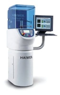

HAIMER GMBH (WWW.HAIMER-USA.COM), A MAKER OF TOOLHOLDERS, balancing machines, shrink-fit machines and accessories, did an internal casestudy on the benefits of using a toolholder balancing machine on its own manufacturing floor. The company found it could reduce costs by $20,000 to $40,000 per machining center per year, depending on the number of shifts that the machining center was used. By balancing its toolholders with tools inserted, the company saw its spindle lives double, a 10 percent increase in cutting volume and a 10 percent increase in tool life. Additionally, it saw improved surface quality and accuracy with reduced chatter and scrap. While tests showed that balancing tools at any rpm range yields positive results, tools and toolholders used on highspeed machines — those with spindle speeds greater than 8,000 rpm — derive the most benefits from balanced tooling.

On a machine, unbalance can result in premature spindle bearing failure and costly downtime. Recent research by several major toolholder manufacturers indicates that tool life can be improved by as much as 50 percent with balanced toolholders and tools. The tool, toolholder and the retention knob (if applicable) should be balanced as an assembly. However, not all tools require balancing. Each tool in a process should be evaluated to determine if the application justifies close-tolerance balancing. Tool rpm, tool weight, tool operation and stress applied on the spindle should be considered.
Unbalance can be a result of fixed sources, including the features of a toolholder, or a result of variable sources, such as the position of the collet, or the position of the collet nut, or the cutting tool, or the setscrews that are used on end mill holders. Fixed sources of unbalance usually are addressed by the toolholder manufacturer through design and prebalancing. Variable sources of unbalance are likely to change each time the cutting tool is changed or when the collet is loosened and re-clamped. Toolholders that do not have moving parts, such as shrink-fit toolholders, tend not to lose their balanced state after they are pre-balanced. Hydraulic chucks also are easy to balance, and retain balancing in use.
Regardless of spindle speeds and the type of toolholder that is used, the cost reduction and other benefits that come from a closetolerance, in-house program to balance toolholder and tools provide quick returns.
