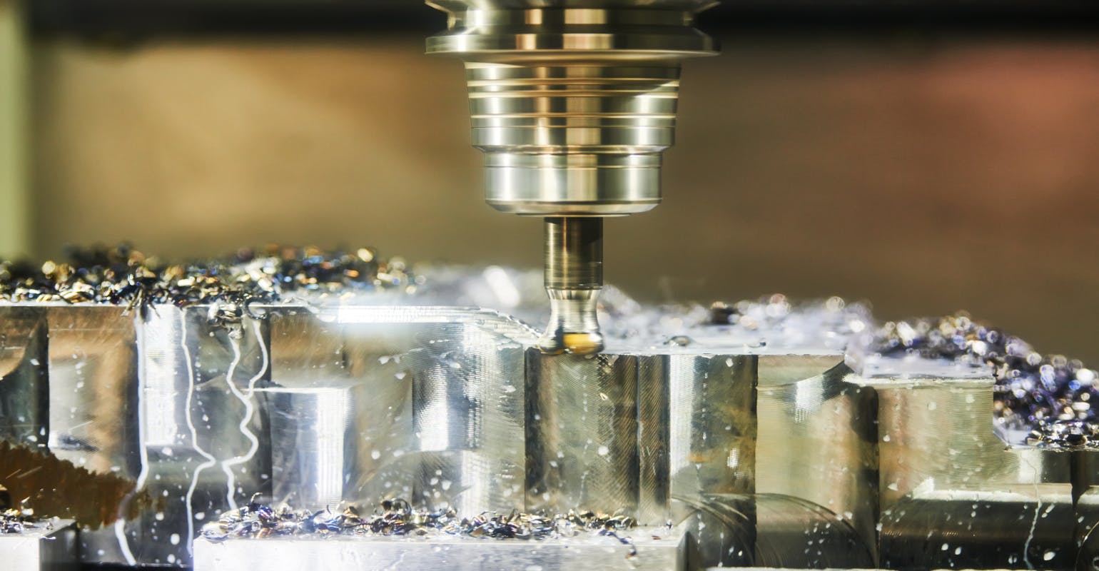

Many metal-cutting optimization strategies focus directly on the cutting equipment. While these choices are critical, manufacturers must also pay attention to related resources and workflows. More specifically, you must use the right lubricant for the job. Your choice of metalworking fluid (MWF) has a significant impact on your equipment’s life span and efficiency. Complicating the matter, the optimal MWF varies depending on the situation. To find the ideal solution for your workflows, you must consider how these lubricants affect your tools and materials. That begins with recognizing metalworking fluids’ (MWF) role in the process.
Decreasing friction, temperature
The most obvious function lubricants perform is minimizing friction during machining. Fluids ensure smooth movement, preventing hard surfaces from touching directly. In addition to enabling a more uniform cut, friction reduction dissipates up to 96% of the heat generated by metal-to-metal contact.
By preventing mechanical damage and heat-related warping, lubricants ensure tooling ends retain their shape for longer. However, different metals have varying needs in these areas. Consequently, a lubricant that is sufficient for one material may not provide enough friction reduction for another.
Aluminum has a high friction coefficient with many other metals, so it requires MWFs with high lubricity, typically meaning less-diluted oils. By contrast, copper alloys and many steels often do not induce as much friction, so you can use lubricants with lower oil contents.
