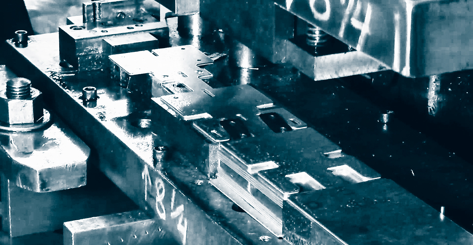

Progressive dies — The fastest, highest-volume part production can be achieved by a progressive die. This accomplishes multiple operations in a single process using hard tooling. Depending on the part, a progressive die uses a metal coil and often can produce a finished part with every machine cycle.
“When an OEM asked us to produce a metal card cage to hold circuit boards, they were spending about $125 per cage,” said Denholtz. “When volume rose to 1,000 parts per week, we reduced the cost to $55 per cage by switching to a progressive die. Although the hard tooling cost was substantial – about $350,000 – the OEM achieved ROI in only five to six weeks.”
