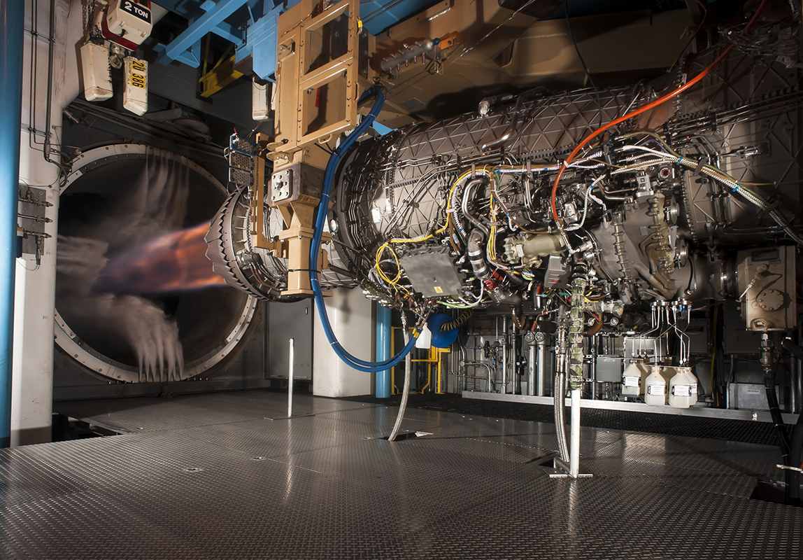

Pratt & Whitney reports that the newest model of its F135 engine, the turbofan jet engine that powers the Lockheed Martin-built F-35 Lightning II, successfully demonstrated "full-life capability" for its cold section – meaning the fan and compressor components. The results were concluded following accelerated mission testing (AMT) at the Arnold Engineering Development Complex, at the Arnold Air Force Base in Tullahoma, Tenn.
The engine being tested is the fifth generation of the F-135. Pratt & Whitney is working with the U.S. Navy and U.S. Air Force to implement increases in thrust and improved fuel-burn rates.  According to reports, the plans include better cooling technology for turbine blades, which would increase engine longevity and cut maintenance costs.
In the specific testing reported by P&W, the engine achieved 9,400 total accumulated cycles (TAC), equivalent to approximately 14 years of operation, or approximately 2,000 F-35 missions. The testing was completed while running the engine at extreme conditions to simulate operational engines.
