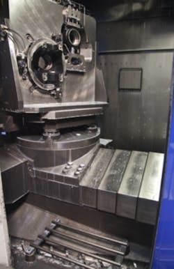

The Michigan shop operates a series of Niigata SPN 701 horizontal machining centers with multiple pallets that help to maintain high-volume operations. The machines are customized with the Hennig chip conveyors, helping to promote Accurate’s productivity objectives.
Correspondingly, the heavy-duty manufacturing equipment here includes a line of Niigata SPN 701 horizontal machining centers with multiple pallets, used to machine very large, heavy workpieces to accuracy standards that rank among the highest in the global market.   As a result, Accurate counts among its customers some of the top manufacturers in that sector, including Meritor, Axle Alliance, Dana and Mack.

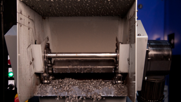

One particular development — a magnetic chip disc filtration system — caught the attention of the team at Accurate because it represented a substantial improvement over traditional drum screen filtration system used on most competing brands.  The relative ease of changeover immediately impressed the shop’s engineers, in terms of productivity and maintenance.
“Replacing the drum filter screens is not an easy task,” Tario explained. “In fact, it can be downright miserable. The Hennig disc arrangement seemed to us a much easier system to operate and maintain.
“The incorporation of a rare earth drum and scraper assembly inside the conveyor appeared to be a great solution for minimizing the amount of cast iron fines reaching the coolant tank side of the system,” he continued. Mark also noted that heavier-duty mechanical components and drive chains used on the Hennig conveyor were impressive, providing a greater wear life and reduced downtime likelihood.

By contrast, with the Hennig CDF system the discs can be removed easily and cleaned on a workbench. It’s not necessary for the maintenance engineer rather to reach through narrow access ports to wrestle with a drum style filter.  According to Tario, this entire process takes no more than two hours to complete.  Simple screen replacements can be done in 30 minutes or less, he noted.
