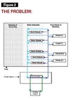

Many pieces of equipment used throughout the plant require cooling, which is carried out by way of a large — more than 180,000 gallon — closed-loop, cooling water system.
The cooling water system, which also is called the welder water system, circulates through a massive matrix of plumbing that covers the entire plant, cooling various equipment and systems such as hydraulic systems, clutch systems, hundreds of welding robots, welding guns and controllers (see Figure 2).
This matrix consists of pipes and hoses that vary in size from 10-in. mains all the way down to -in. hoses and smaller orifices.
Around the year 2000, Metal Assembly began experiencing unusual equipment failures.
The weld cables (kickless cables) on the welding robots would become completely clogged, sometimes to the point of splitting. They continually experienced low-flow faults to the robot welding tips.
These issues led to production downtime as equipment parts were replaced and repairs made. Another complaint - perhaps the largest - was from the maintenance personnel. They complained of an unpleasant odor coming from the cooling water as they made the repairs.

The statistical engineering project initiated by GM’s chemical management services provider was based on the problem statement: “Find and eliminate the root cause of contamination in the cooling water system causing downtime in Metal Assembly.”
By following statistical engineering methodology, the chemical management services provider identified what the contamination actually was, where it was coming from, and how to stop it.
The problem had to do with heat exchangers (see Figure 5) on highpressure hydraulic systems — not the units themselves, but rather with the plant’s start-up procedure.
“Using the statistical engineering process, the chemical manager was able to prove where and how oil was contaminating the plant’s cooling water. We had previously suspected the heat exchangers, but our conventional testing methods were unable to detect the leaks,” Steve Andreen, manufacturing engineering director for General Motors, said.
Once the contamination was stopped, the chemical management services provider began the process of cleaning out all of the residual contamination left in the cooling water system.
The effects were dramatic and nearly instantaneous.
Oil usage in the suspect systems decreased (see Figure 6), reducing the plant’s overall oil consumption. Metal Assembly no longer experienced blown cables or clogged water lines, greatly reducing production downtime and maintenance costs.
Pipe-fitters no longer needed to drain sections of the cooling water system on overtime. No longer were totes of black, foul-smelling water being sent to the plant’s wastewater treatment building for disposal, and no longer was the plant’s utility manager required to add large amounts of corrosion preventing chemicals to the cooling water system in order to maintain the required levels. The plant’s water usage decreased, as did the amount of water the plant sent to the city for treatment.
