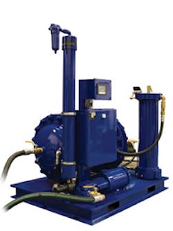

Driflex is designed to remove all free, emulsified, and dissolved water from oil in batches of any size. Initially, the system appealed to Smith & Wesson because of its convenience: it would allow the company to process oil in its own plant, on its own schedule, and in virtually any volume they wanted. In addition, keeping the oil processing in-house would eliminate the costs of clean-up services associated with off-site processors or third-party truck-mounted vacuum dehydrator systems. Not only did clean-up services cost tens of thousands of dollars annually, but they also presented the risk that the oil would be permanently damaged and lost during the cleaning process. Along with eliminating this risk and additional cost, it was apparent that Driflex system would improve overall oil quality.
Driflex oil conditioning couples Pentair’s patented UltiDri® membrane technology with high-efficiency filtration to remove known, harmful contaminants from vital lubrication and hydraulic fluids cost effectively. The system operates by flowing contaminated oil through a particulate filtration stage, followed by a membrane filtration and an air-drying process. The result is that both particulate and moisture are removed from the oil, and the oil is restored to optimal condition for reuse.
Smith & Wesson processes lube oil in 250 to 300 gallon totes, replacing two to three totes (or 500-900 gallons of oil) per week. To service the oil, the company selected a 4 gpm Driflex Model #DF-04L4CS400 to meet their volume and processing time requirements. A Driflex system of this size is capable of processing the company’s typical weekly volume of oil within a few days, with no external schedules to accommodate or third-party expenses.
