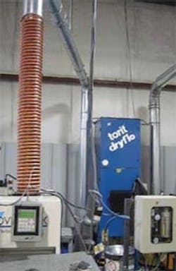

Clamp-together ducting along with short pieces of flex hose are easy to disassemble and re-assemble when machines need to be moved.

A proper flex hose installation for mist collection.
A poor flex hose installation for mist collection (notice the sag).

Flex hose is used just about everywhere in mist collection – to connect a machining center to a mist collector or to connect to overhead ducting in a cellular or central system. Shops often incorporate flex hose where hoods need to be moved. They also use it with centrifugal mist collectors because flex hose is easy to maintain and because such collectors are typically located less than 10 ft away.
The only real problem with flex hose arises due to poor installation. If flex hose is not hung properly, a pool of liquid may develop and cause it to sag, eventually plugging up the hose and cutting off the airflow. Flex hose should always run vertically, not horizontally.

Flex hose lengths should never be longer than 10 ft. Use solid ducting as far as possible and run only the last few feet with flex hose. Flex hose requires more pressure drop due to internal resistance caused by the metal helix surrounding the hose.
Flex hose should be well supported and never installed horizontally. Liquid will build up, and as quantities increase, the flex hose will sag and blind off the airflow.
