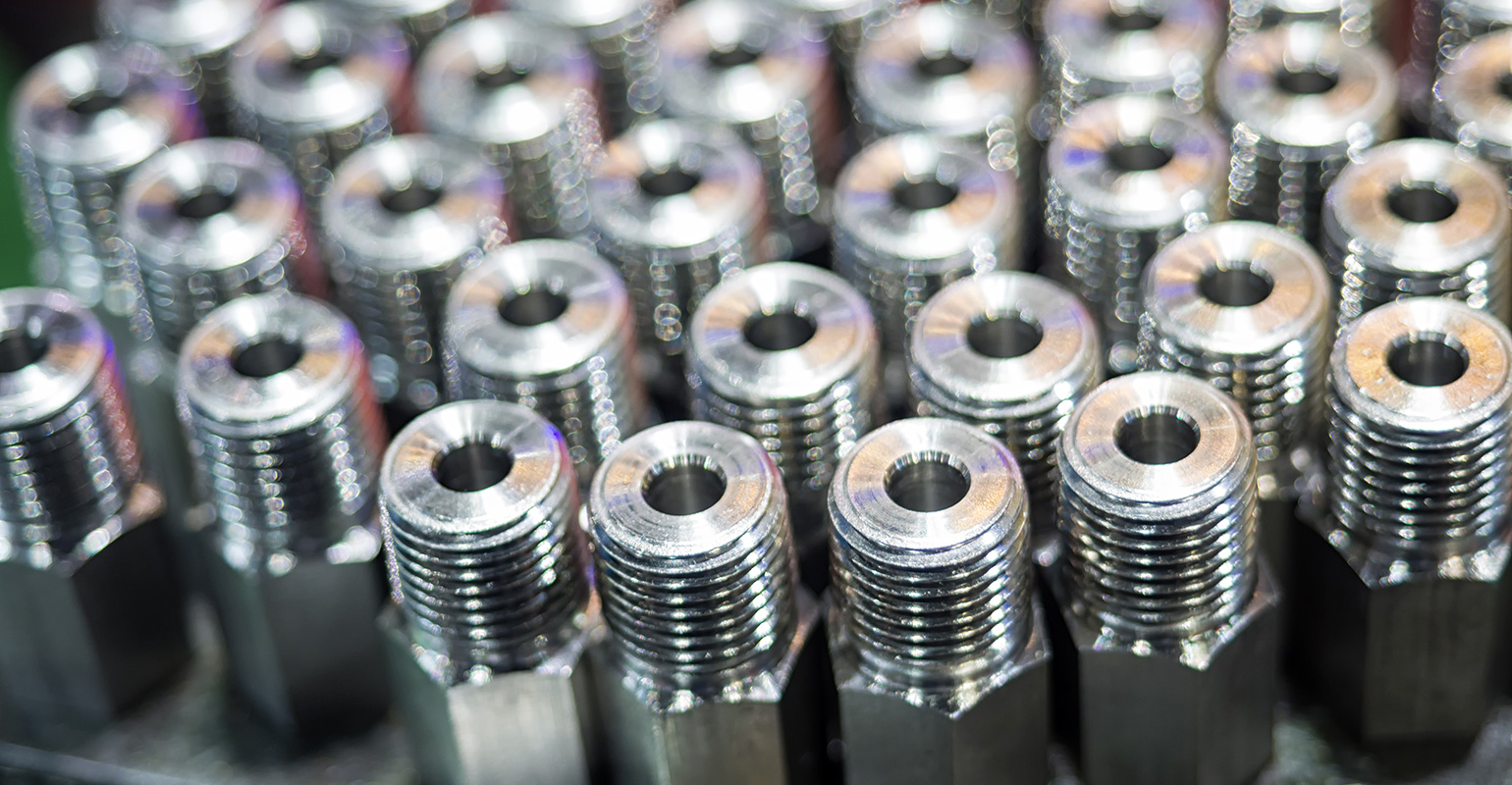

3. Prioritize Structural Components. One way to keep down the costs of tight CNC machining tolerances is to prioritize tolerances for structural components. These aspects are critical to your part's structural integrity or functionality.
Precision screw parts are a great example. Well-machined screws, drive axles, gears and other precision screw components are critical for performance, safety and functionality on all kinds of parts and objects. Because these parts typically use a standard screw thread or other measurements, they have tight tolerances to be compatible with other critical parts.
For mission-critical parts like this, paying a little extra for tight tolerances is often worth it. If you are working on a limited budget, prioritize tighter tolerances for structurally essential parts first rather than trying to assign every aspect of your piece a tight tolerance.
