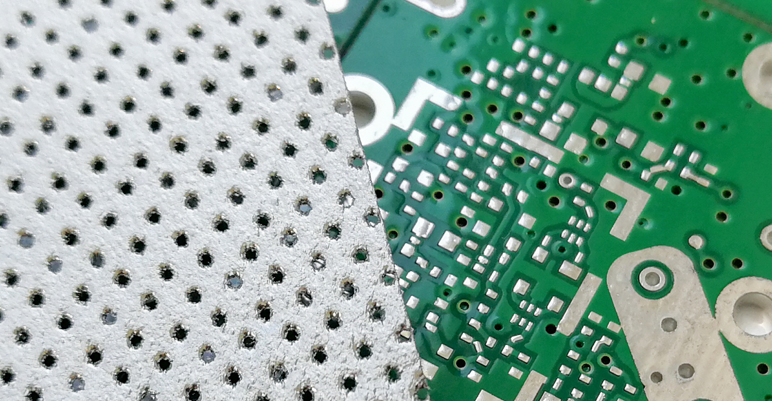

9 Popular Choices for EMI Shielding
All electrical devices emit magnetic or electrical energy due to radiation or conduction. Sometimes, electromagnetic interference (EMI) adversely affects the performance of a machine or the reliability of a transmission channel. Thus, it's often necessary to mitigate the problem by using EMI shielding materials.
The most common source of electromagnetic interference is radio frequencies between 1 kHz and 10 GHz. Other causes include arc welders and electrical noise.
EMI shielding involves either protecting a sensitive device or signal from electromagnetic interference or making it so that whatever emits the interference does not affect other equipment in the area. Here are nine of the most widely used options for EMI shielding.

5. Pre-tinplated steel — This option works well for shielding frequencies in the kHz to the lower GHz range. It's a modestly priced choice, and tinplating gives this material excellent corrosion resistance. Additionally, pre-tinplated steel's surface makes it possible to attach the shield to a board via soldering.
