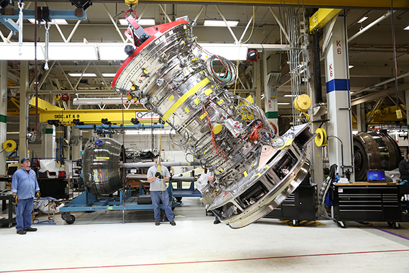

GE Aviation reported that final assembly is underway on the first full GE9X engine, in preparation for testing in the first half of this year. The first GE9x engine is scheduled to enter service in 2020, powering the forthcoming Boeing 777X series twin-engine aircraft. Almost 700 GE9X engines have been ordered.

The first fully assembled engine marks the end of the GE9X “technology maturation program” that GE Aviation began almost five years ago. It has covered testing of new components and systems, and core demo testing to validate advanced technologies and materials.
The next stage of development is called the “first engine to test (FETT) phase. FETT brings all the technologies together to demonstrate their operability as a complete propulsion system, and collects early information on the engine’s aerodynamic and thermal characteristics.
