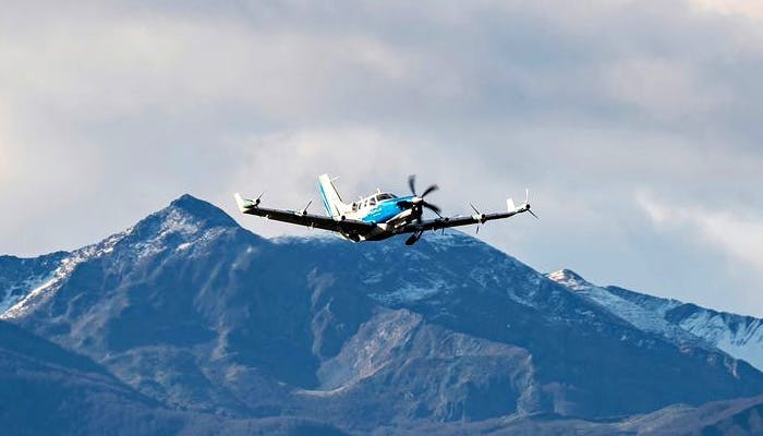

The EcoPulse hybrid-electric distributed propulsion aircraft project completed a successful first flight for its demonstrator model. The aircraft flew for approximately 100 minutes with its “ePropellers" powered by a battery and a turbogenerator, Airbus reported.

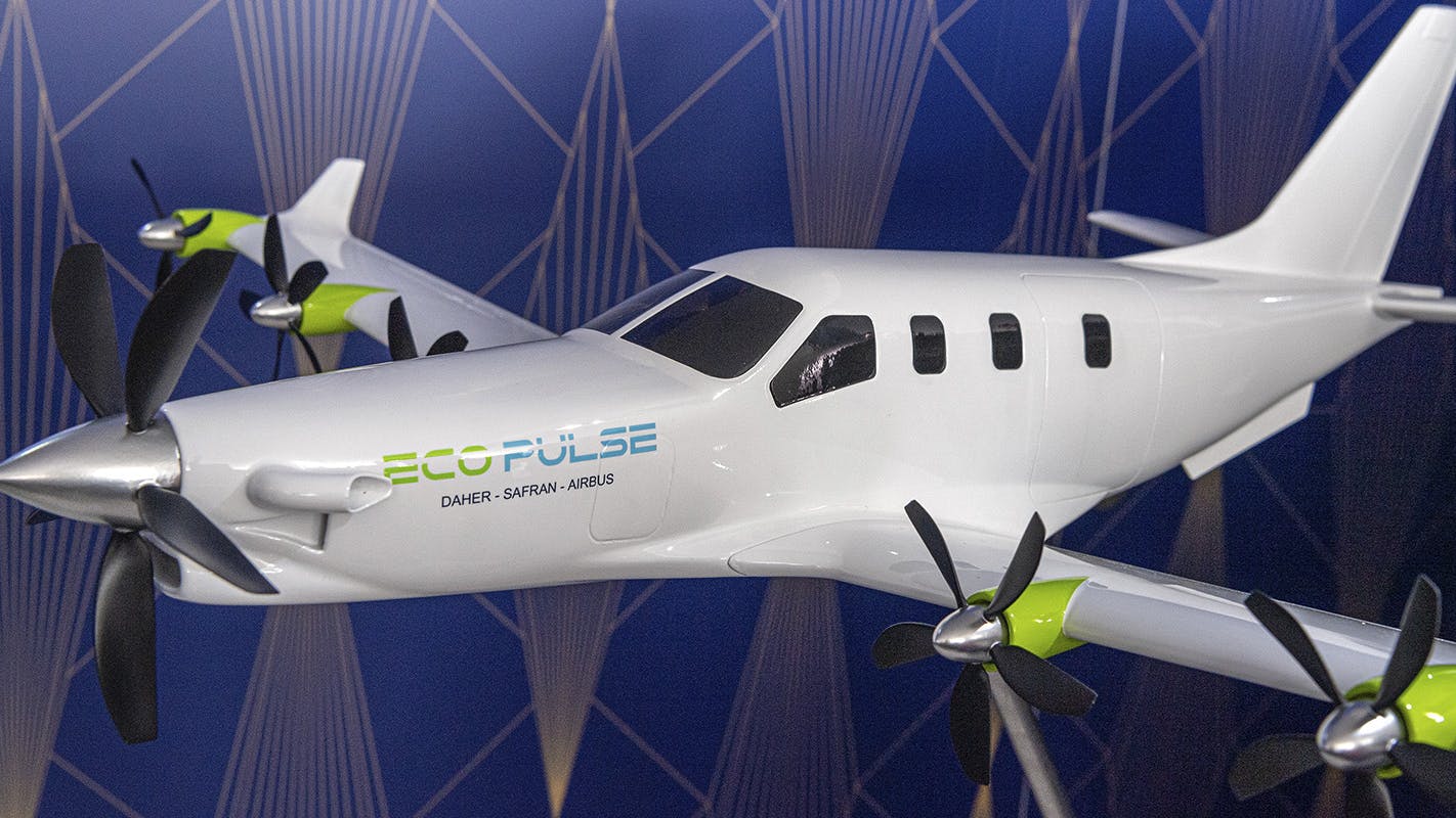

The aircraft is based on a single-engine, Daher TBM light aircraft, equipped with six integrated electric thrusters (e-Propellers, supplied by Safran), arranged along the wings. The propulsion system integrates an electric turbogenerator driven by a Safran gas turbine and an 800-V DC battery pack, supplied by Airbus.
A Power Distribution and Rectifier Unit (PDRU) protects the high-voltage network and distributes the available electrical power.

During the demo flight, the crew engaged the electric propellers and verified the proper functioning of the aircraft’s flight control computer, high-voltage battery pack, distributed electric propulsion and hybrid electric turbogenerator.
