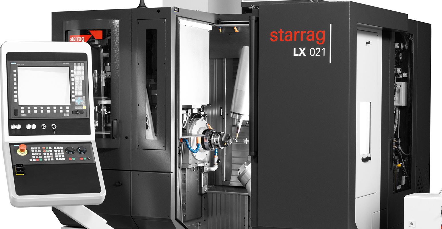

The LX021 is a six-axis machining center designed to optimize lights-out machining of complex blades, from raw stock to finished form in a single operation.
STARRAG USA’s new LX021 turbine blade machine is an application-based design that maximizes part rigidity with its spindle and sub-spindle part clamping. The turret on the sub-spindle allows multiple workholding strategies to be used, for full machining of blades in a single set-up.
The LX021 is a comprehensive, integrated system that includes:
•  A self-centering vice that minimizes part distortion while maintaining accuracy and repeatability.
•  Kinematic correction cycles to calibrate the machine and verify its health over time.
•  Advanced, RCS CAM software designed specifically to generate optimize CNC tool paths.
•  RCS blade inspection measures blades and compensates for forging variations to increase first-time yield.
•  A 10-pallet storage system with a spindle-loaded part gripper to automate part set up for continuous operation.
Starrag's full solution includes Blum-Novotest Inc. probing technology for in-process part measuring, tool setting, and surface roughness verification.
The surface-roughness gauge is programmed with five-axis motion directly in the RCS CAM software. Roughness measurements can be made on surfaces as low as 16 μin Ra. After in- process measuring, the data is saved ready for SPC quality monitoring.
