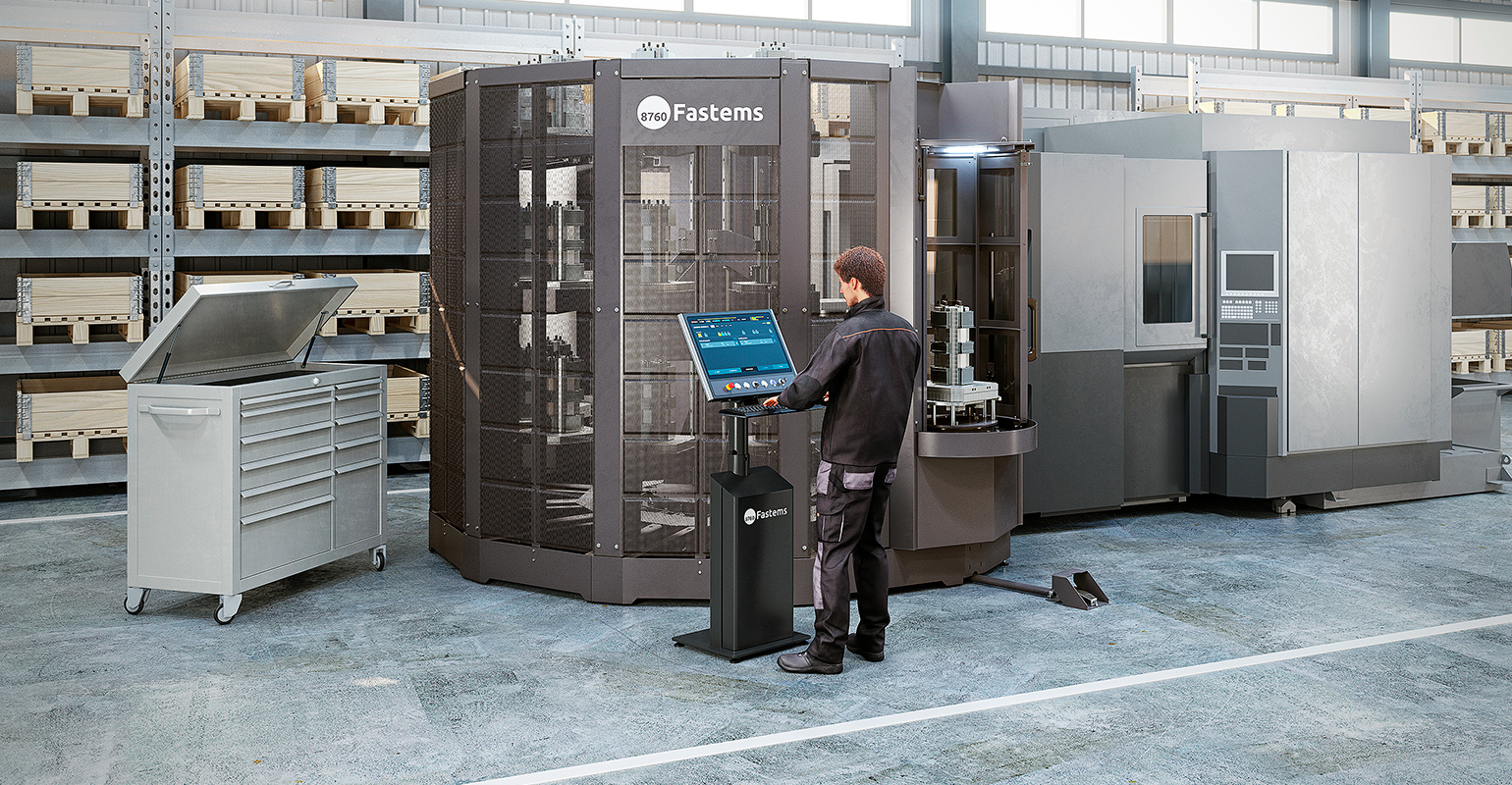

FASTEMS LLC launched the new Flexible Pallet Tower (FPT), a compact pallet automation solution for a single CNC milling machine with 300 to 630 mm pallets. FPT integrates with any machine and offers a wide choice of ready-made machine tool interfaces. It will increase machine tool utilization by reducing set-up times and supporting lights-out manufacturing. The plug-and-play automation system also shortens the lead times and allows for higher part mix with smaller unit costs, no matter the production batch sizes.
Compared to similar systems, Fastems FPT is compatible with any machine tool brand and integrates with milling machines, whether or not they have automatic pallet changers.
The system footprint is extremely compact: FPT-500 for 300- to 500-mm pallets requires only 100 square feet; and FPT-1000 for 500- to 630-mm pallets requires 175 square feet. Instead of having a fixed storage, like most of the comparable units, FPT can work with different load heights and pallet sizes with a configurable pallet storage that can hold up to 24 pallets in two to four levels.
