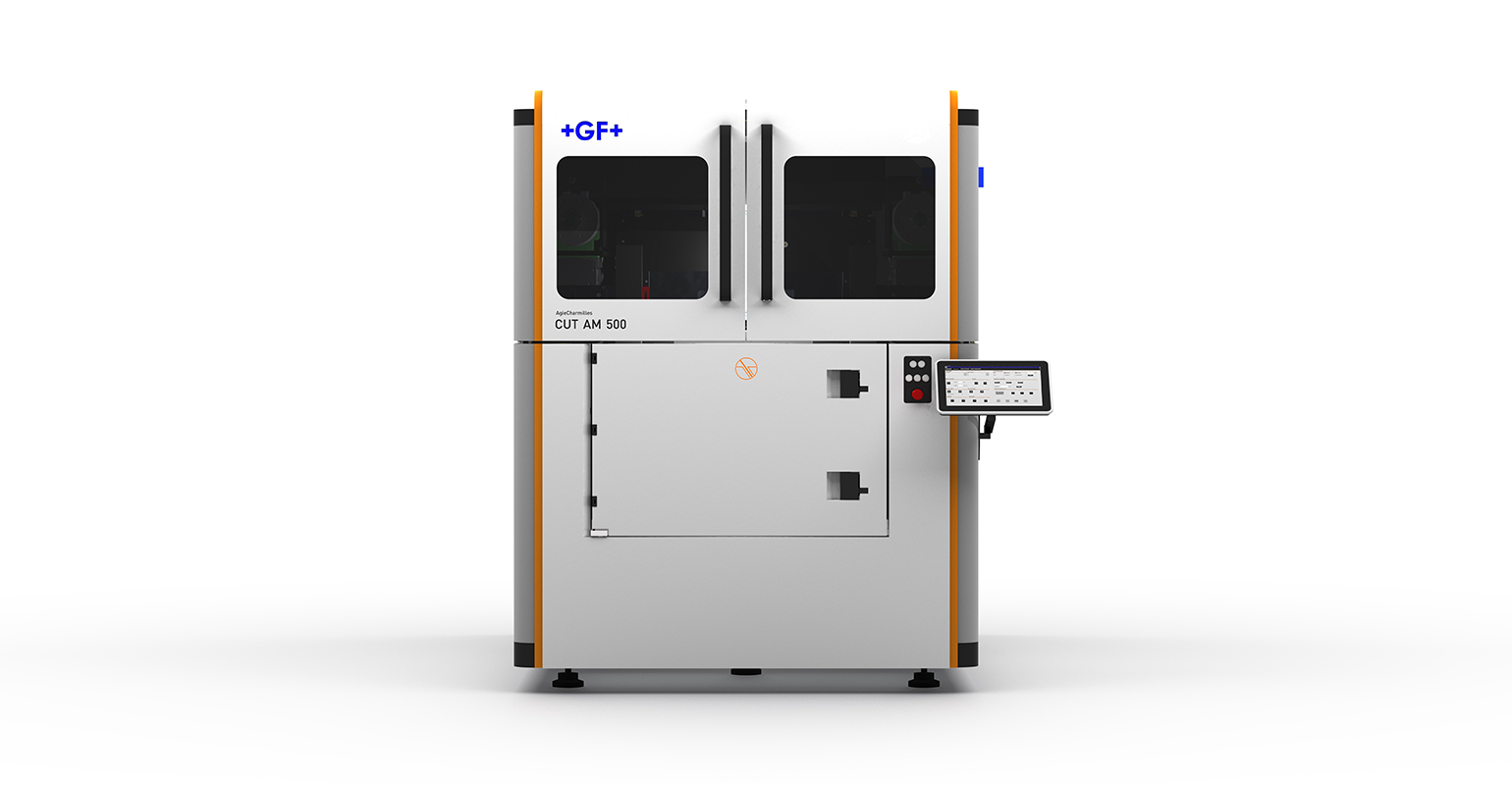

Designed specifically for the additive manufacturing process, the CUT AM 500 horizontal wire EDM makes it easy to quickly separate AM metal parts from build plates while maintaining geometrical accuracy and ensuring assembly readiness. The machine is a fast, precise, affordable, and automation-ready alternative to the use of standard vertical EDM equipment or band saws to separate parts from build plates.
In addition to improving overall efficiency, the CUT AM 500 also resolves a number of quality barriers encountered by manufacturers created by the use of band saws, including (but not limited to) geometric inaccuracy, loss of workpiece material (kerf), and damage to the part. Learn more at www.gfms.com
