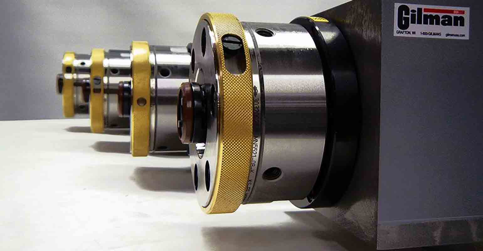

4. The spindle “hotel” program — The spindle “hotel” program expands on preventative measures by coordinating the use of more than one spindle of identical design. The spare spindle acts as a replacement in case the main spindle breaks down. The spare is kept either on site or at a designated repair facility. The advantage this arrangement is that downtime remains low: If the spindle breaks down the spare replaces it and production does not have to stop to wait for it to be fixed.
The downside to such a program is that the amount of capital sitting in the “hotel” could outweigh the convenience of the program. If this is the type of program your operation follows, Gilman Precision will provide its Spindle R&R service, which allows any spindle to be housed for up to 12 months after being repaired.
